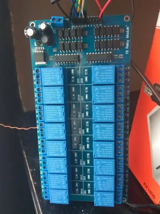

A picture of the module

Switched from 5v to 3.3v connection pin from the rPi and it worked fine.
As per @joan's and @goobering's recommendations it seems like 5v (although clearly indicated on the board) was too much as the module was already powered by 12v adapter.
Unfortunately it was an ebay purchase so there was no documentation along with the board.
BTW, just for the reference, i only had to use 1 3.3v pin and 1 GND pin for the thing to work (there are two of each on the relay board).
