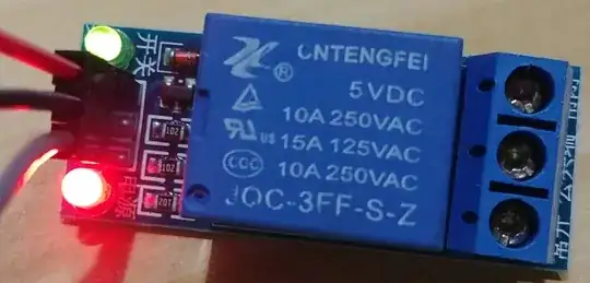

I've got a small 5v relay board ("Ontengfei" JQC-3FF-S-Z) connected to my Raspberry Pi 3 B+. When I set the GPIO pin mode to OUTPUT, the relay turns on. When I toggle the GPIO pin between HIGH / LOW, the relay just stays on, it doesn't toggle like I'd expect it to. If I set the GPIO mode to INPUT, the relay turns off. This is really confusing, because I'd expect toggling LOW / HIGH, while the GPIO pin is in OUTPUT mode, to turn the relay on/off.
Relay image
I'm using physical pin 12, wPi 1, BCM 18, depending on your preference. Even though voltage is set to 0 (LOW), the relay is still receiving a signal.

What I've tried
  • Adding various resistors in between the GPIO pin and the relay, to reduce the voltage
  • Tried physical pin 8 and 12; both exhibited the same behavior
  • Added a diode to prevent voltage from being sent from the relay board to the Raspberry Pi. It still worked as above, but didn't fix the issue.
  • Connecting it to 3v3 power instead of 5v (same behavior)
Without knowing the nature and needs of the mistery relay board is hard to help. Nonetheless I'll try. This are steps that I'd try to solve the problem:
  • Connect led diode trough some resistor and see if that lights up as expected
  • figure out what drives the relay (low or high) signal
  • once established that figure out at what voltage relay triggers
  • for RPi protection I'd use optocoupler triggering for relays
  • Try some other GPIO like 24 or 23 as they don't have alternative functions
Bungee75
  • 121
Even though the relay clearly says it's a 5v relay, it only worked when I connected it to the 3v3 power rail.
