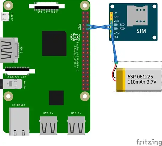

Here is how I'm trying to connect it:
montage

The circuit as shown will not work as there is no common voltage reference between the SIM and the Pi.
You need to connect a Pi ground to either the SIM ground or to the battery ground (-ve terminal).
