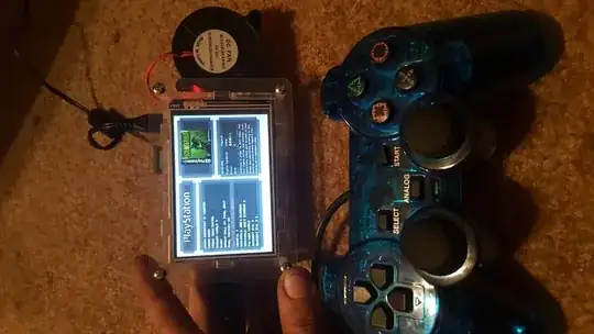

I'm building a portable gaming system and I have a power bank coming in for it
I want to know if it will indicate a warning if my "battery" is not supplying enough power so I know when to shut it down.
I've seen many things say something should pop up on the top right of the screen but I still can't find out if it will come up while you're in an os of any kind or just specific ones.
I'm sorry for the noob questions but I've only been working with these for pi things for 3 days now and I'm really excited about this game system iv put together
