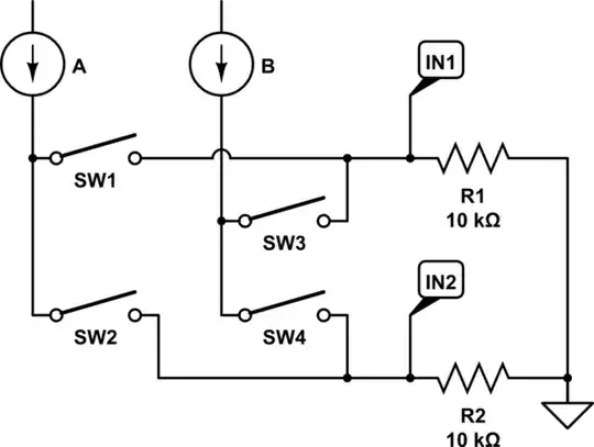

To apply this to buttons you need a slightly different strategy, providing power to "columns" that can be toggled and then testing the return "rows" with inputs. Shown below, the GPIO output columns are labeled A and B and the GPIO input rows are labelled IN1 and IN2. For simplicity I've used four buttons, which multiplexed this way is a bit pointless, but if there were 9 buttons you would only need 3 outputs + 3 inputs = 6 GPIOs. The numbers do not have to be the same, so with 20 buttons you could use 5 outputs and 4 inputs -- or 4 outputs + one non-toggle 3.3V connection as an output line or, as in my LED/photoresistor scenario, one ground line without an input (to save a GPIO), a total of 8 GPIOs. I'll explain why you can leave one GPIO output out in more detail.

The inputs (IN1, IN2), are set as interrupts. Note they are pulled to ground through a resistor (this also limits the current from the GPIOs, and more importantly, the 3.3V rail if you use it as a source for one column). The outputs are both set high. When an input triggers, you then turn off all but one of the outputs and cycle through them (not necessary here since there are only 2).
  • IN1 triggers and stays high when B is turned off = SW1
  • IN2 triggers and stays high when B is turned off = SW2
  • IN1 triggers and goes low when B is turned off = SW3
  • IN2 triggers and goes low when B is turned off = SW4
Note you never have to toggle A -- this is why one of the inputs can just be the 3.3V rail, saving one gpio, so with a 5 x 4 grid you would only need 8 GPIOs. Again, alternately you could have one ground line without an input on it.
