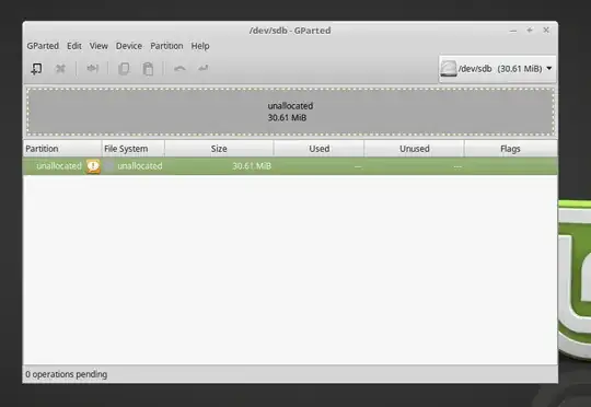

I figured this was because I was using a newer version of Retropie, and it somehow needed to be partitioned in a different way than older versions). So, I booted up Linux Mint on a Virtual Machine, and connected my card in hopes that using GParted I could format my card and start over. However, upon opening GParted and looking at the drive, I am greeted with what is shown below. As you can see, GParted only sees 32 MB device, instead of the two separate partitions which I was hoping to see. I could not interact with the space at all, as it said there was no partition table.
I then attempted to create a partition table, and it completes with no errors, but nothing is actually created. Am I screwed and I need to get a new card? Am I doing something stupid? I'm seriously at an absolute loss at what to do, and any help is greatly appreciated.

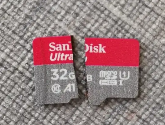

I have the same issue that @thatoneguy245 and test my 32 GB sd card on windows and Unix with all solutions found on Google. But, after many many many pull push SD card from different devices.
I found the issue : the strength of the card was broken and micro power cuts broke the links and create circuit breakages. I only saw it after returning the SD card black side and pressing lightly on both sides. Transformation of the card into a double card ... but not from 32 GB to 64 GB. Fragility of the current cards hoping that they are not even finer in 10 years!
Nostalgia of the time of ZIP cards and others 3/4 formats...
Not fix or warranty for this, finally. broken sd card

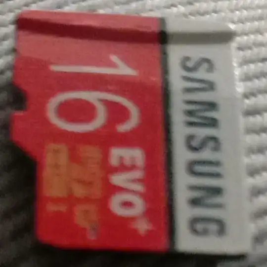

I have same problem with an 16GB SD card of Samsung. After trying all the software solutions available on internet i moved onto hardware issues and figured out there is very small crack on the SD card that can not be observed easily. i observed it with flashlight.
SD Card Image
Its cause was the SD slot of raspberry pi. I put the PI in my backpack where he received some kind of force on it that resulted in crack. After this crack the SD Card shows on the windows disk Management as 13MB RAW Disk and noting else.

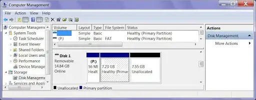

Windows has great difficulty reading a SD card after the raspberry Pi installed files on it. My SD Card had 2 partitions, the first one only being 61 MB, the second one was 26 GB. Next to that, there was almost 1 GB unallocated.
Windows can only see the first partition, thus showing the card as 30/61 MB.
However, Windows Disk Management does recognize everything. Check it here:
Computer Management - Disk Management screenshot
This screenshot is from another site, but it shows the problem. In this case, Windows Explorer only shows a 56 MB SD card, while the SD card is 16 GB.
Start > type in "Create and format disk partitions"
Now, I wanted to completely reinstall Rapsbian, so what I did is the following:
  1. Delete the large middle partition
  2. Delete the small partition on the left
  3. Create a new simple partition
For me, the application recognized that there was 29 GB of unallocated space. I was able to make a new 29 GB partition. From there one, I started from scratch in installing Raspbian and Retropie.
