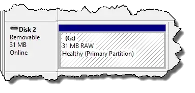

But there are circumstances where I also had to pull the plug. After that the Raspberry did not boot anymore. No LED blinked and I only got a black screen. So I took the SD card and checked it on my PC. Windows was only able to recognize 31 MB RAW partition: Recognized Partition
Now I am not able to delete or format the partition. I already tried to format/delete the card using:

diskmgmt.msc:
The format did not complete successfully.
Diskpart:
No usable free extent could be found. It may be that there is insufficient free space to create a partition at the specified size and offset. Specify different size and offset values or don't specify either to create the maximum sized partition. It may be that the disk is partitioned using the MBR disk partitioning format and the disk contains either 4 primary partitions, (no more partitions may be created), or 3 primary partitions and one extended partition, (only logical drives may be created).
Gparted: Partition is not able to create a partition table at all.
DD:
dd: error writing '/dev/sdc': No space left on device 31+0 records in 30+0 records out 32096256 bytes (32 MB) copied, 3.6677 s, 8.8 MB/s
I am sure the card is broken after trying everything I can think of. My questions are now:

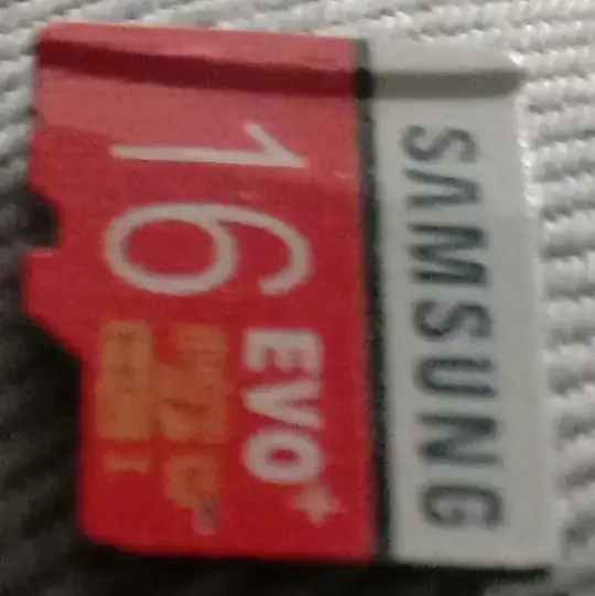

I have same problem with an 16GB SD card of Samsung. After trying all the software solutions available on internet i moved onto hardware issues and figured out there is very small crack on the SD card that can not be observed easily. i observed it with flashlight.
Image of SD Card
Its cause was the SD slot of raspberry pi. I put the PI in my backpack where he received some kind of force on it that resulted in crack. After this crack the SD Card shows on the windows disk Management as 13MB RAW Disk and noting else.
