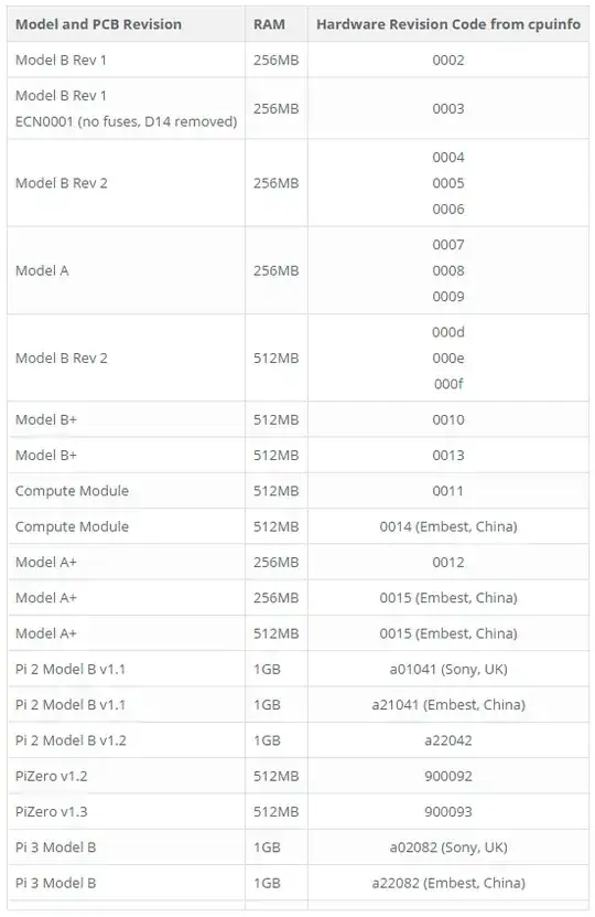

By Hardware Revision
If you need to be more specific, you can check the revision entry from the output of cat /proc/cpuinfo. If you want to just exact the revision number, the following command should do it:
cat /proc/cpuinfo | grep 'Revision' | awk '{print $3}'
Revision Numbers
This webpage has a handy chart that I've copied here.

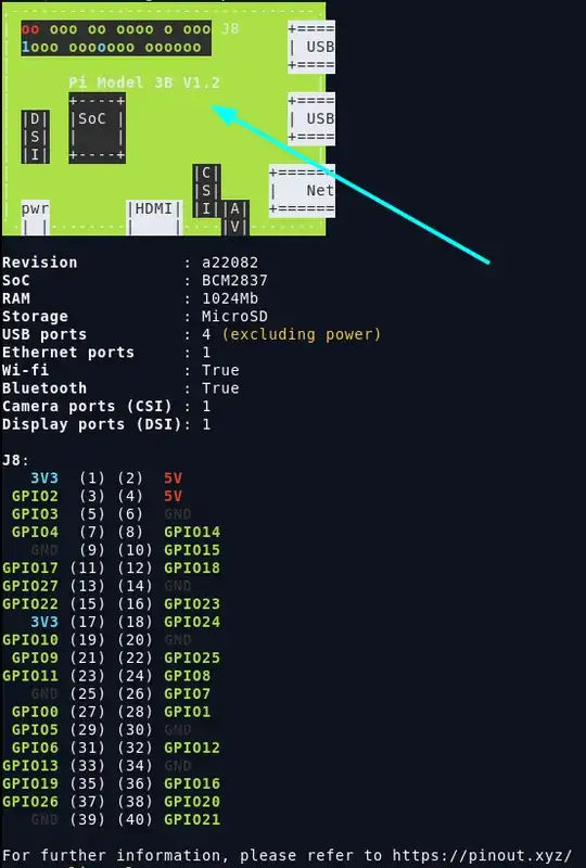

You could also use tool called pinout
