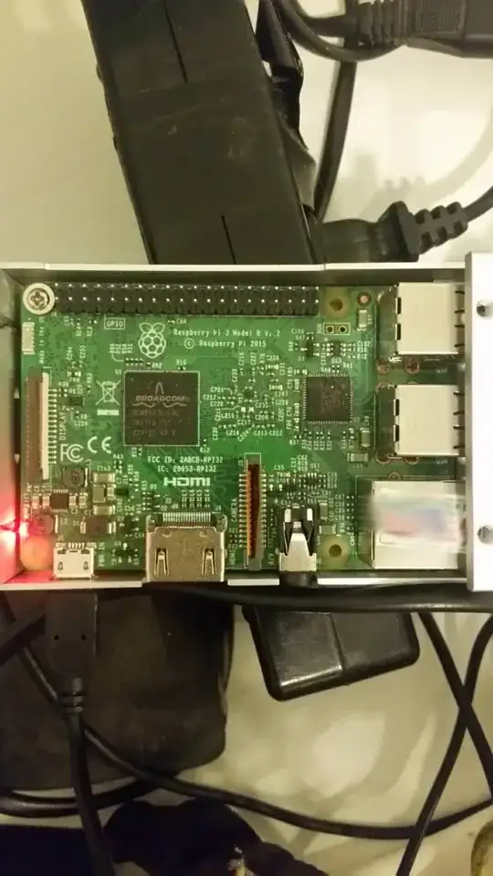

Hello,
I recently purchased what I believed was a Raspberry Pi 3 B. Now I am suspicious that it may not be.
lscpu shows as below. But Raspberry Pi 3 B is supposed to have armv8, no?
Architecture:          armv7l
Byte Order:            Little Endian
CPU(s):                4
On-line CPU(s) list:   0-3
Thread(s) per core:    1
Core(s) per socket:    4
Socket(s):             1
Model:                 4
Model name:            ARMv7 Processor rev 4 (v7l)
CPU max MHz:           1200.0000
CPU min MHz:           600.0000
BogoMIPS:              38.40
Flags:                 half thumb fastmult vfp edsp neon vfpv3 tls vfpv4 idiva idivt vfpd32 lpae evtstrm crc32
Also, the sticker on the board says Raspberry Pi 3 B Copyright 2015. But the RPi3B was released in 2016, no?
Is there a way to confirm if this is a real RPi3B or a counterfeit unit? The box says 3B and there is some kind of 7 digit reference number if I can check that somewhere.
