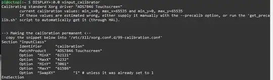

Edit - Steps I did with xinput-calibrator:
DISPLAY=:0.0 xinput_calibrator
Output is: enter image description here
I copied the Section to EndSection part into:
/etc/X11/xorg.conf.d/99-calibration.conf
After the restart, nothing changes. I also tried to change the "SwapXY" Value to 0. Again no changes.
