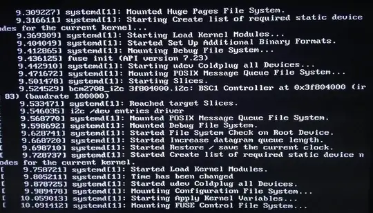

I'd like to run my RP 3 on LCD 32". But when I try to run, loading is stopped after 9-10 seconds of starting up and the last line in the console is: "Mounting FUSE Control File System..." After this communicate console is stopped.
Below, I show the screen from the LCD with this console log.
I'd like to add, that on my 3.5 GPIO it works properly.
Does somebody have any suggestion what could went wrong? I would really appreciate if someone could help me to resolve this problem.
