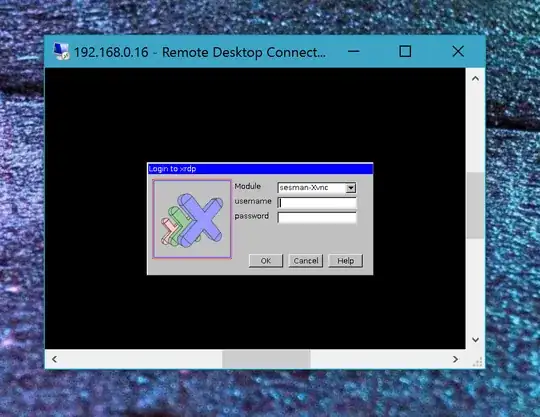

I ran:
sudo apt-get update
sudo apt-get install xrdp
I wen't to Windows 10 remote desktop connection and connected to my Raspberry Pi 3:
Then I entered default credentials credentials (pi/raspberry) and I got this log:
The login was successful but "Problem Connecting"... not very informative I'd say. Anyone knows what to do with it?

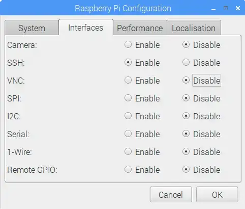

It appears to me that Raspberry Pi 3 is the first Pi to come pre-installed with RealVNC, and RealVNC interferes with xrdp, so we must break the RealVNC install in order to get xrdp to work. You can see that RealVNC is installed by going to Start --> Preferences --> Raspberry Pi Configuration. You will see the following:

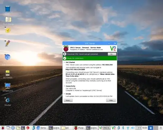

If you enable the VNC option and click "ok," you will see the VNCServer icon pop up in the bottom-right-hand corner of the screen. Its icon starts with a green capital "V". Click on the icon if you want to see the server window pop up, like this:
Anyway, close it and go back to the Raspberry Pi Configuration and disable it if you enabled it.

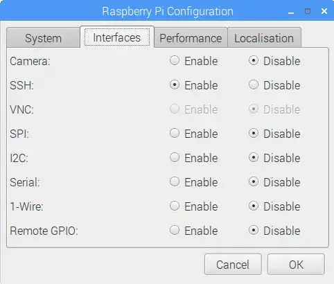

Now, when you go to Start --> Preferences --> Raspberry Pi Configuration you will see that RealVNC is broken because the VNC option will now be greyed out as follows:
Done! Remote logins using xrdp now work.
