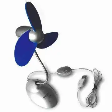

You can use one usb fan with "on/off" switch.
