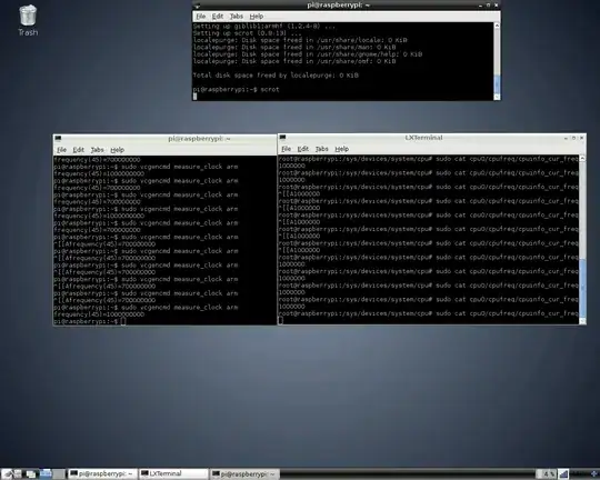

Below is a screenshot of my tests with the two methods using two terminals:
  • Left terminal uses vcgencmd & Right terminal uses cat to check cpuinfo_cur_freq
  • Top terminal was used to execute scrot command for the screenshot
  • It is also worth noting that I used the ordinary terminal for vcgencmd and the root terminal for the cpuinfo command.

The vcgencmd command is the more accurate one as the vcgencmd command takes the reading from the firmware and the cpuinfo_cur_freq takes the reading from the kernel. The problem with using cpuinfo_cur_freq is that when the cpu throttles due to too low load, undervoltage, or high temperature, it does not get reported back to the kernel.
Source here and here
I hope this helps :)
