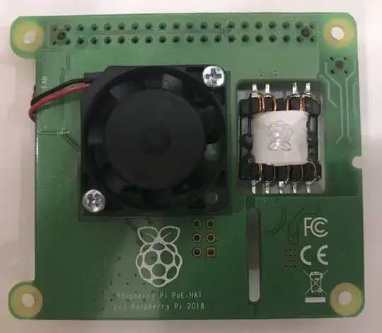

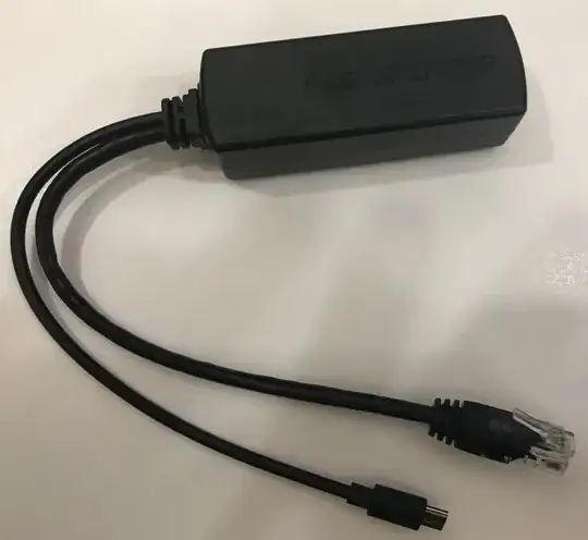

You have (2) options to power a Pi from your PoE switch (USB is not one of them):
PoE Hat: powers a Pi by just connecting the Ethernet cable to the Pi's Ethernet port; job done. Presently £20 (inc VAT) from all Pi retailers
PoE Splitter: has two connections: an Ethernet for data and a MicroUSB that diverts the power from the switch to the MicroUSB port cable that plugs into the Pi's standard power port. Presently £9.90 (inc VAT) on Amazon.co.uk
Both solutions work well, but one might be more suitable in respect to physical form factor form factor of the Pi's enclosure: the PoE hat adds a lot of bulk.

PoE Splitter
PoE Hat
