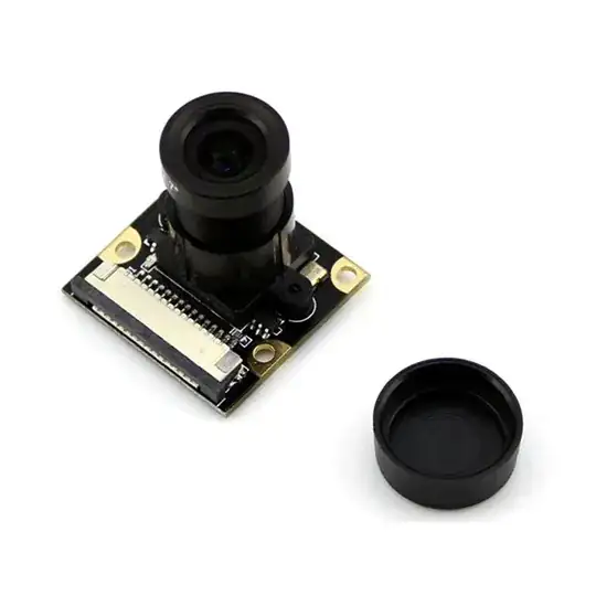

Just be aware that those IR LEDs have copper contacts on them for power and many of the stock RPi cameras don't have the contacts to mate with the LEDs:
This camera has the correct copper contacts on it for those IR LEDs: enter image description here
