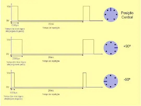

According to this formula:
pwmFrequency in Hz = 19.2e6 Hz / pwmClock / pwmRange
We can set pwmClock=1920 and pwmRange=200 to get pwmFrequency=50Hz:
50 Hz = 19.2e6 Hz / 1920 / 200
I test it on alarmpi:
$ pacman -S wiringpi
$ gpio mode 1 pwm
$ gpio pwm-ms
$ gpio pwmc 1920
$ gpio pwmr 200     # 0.1 ms per unit
$ gpio pwm 1 15     # 1.5 ms (0º)
$ gpio pwm 1 20     # 2.0 ms (+90º)
$ gpio pwm 1 10     # 1.0 ms (-90º)
Note: My servo expects a 50Hz signal.
