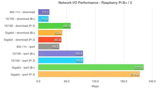

Using any Pi other than a Pi 3, I'm led to believe that using a USB 3 Gigabit ethernet adapter in a USB socket can work wonders for your connection speed. This piece on jeffgeerling.com suggests that he managed to significantly improve network throughput in this way.
Network I/O performance - Raspberry Pi B+ / 2
