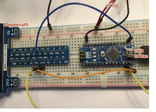

I only use simple wires on a breadboard to connect the two devices, no other components involved. These are the connections:
- Pi MOSI - Arduino D11
- Pi MISO - Arduino D12
- Pi SCLK - Arduino D13
- Pi GND - Arduino GND
Pi 5V is connected to a bench power supply. The Arduino is powered via USB cable connected to my Mac. Ground is common.
Here's a picture:
