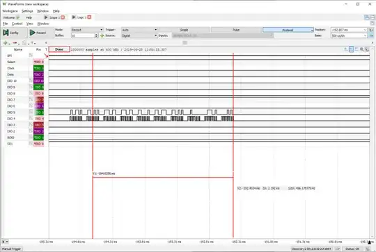

If I use the flag to select auxiliary spi, I get clock and data, but SS doesn't go low.
Auxiliary SPI, CE1

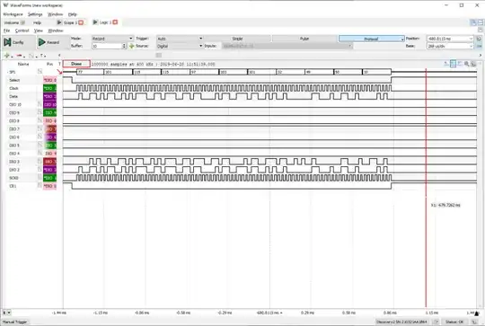

If I don't use a flag and monitor primary SPI with CE1, I get a good connection enter image description here

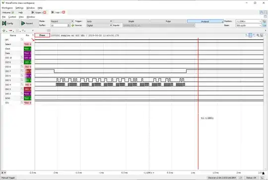

If I use channel 2 (the one normally associated with auxilary spi), I get data as well as CS2 low (MISO is not connected to the slave for this sample) enter image description here
