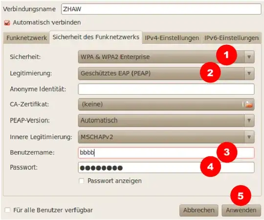

As the title suggests, this question is very closely related to this question. And following the instructions by Lucas Goossen, I'm able to get a inet addr on my wlan0 (confirmed by ifconfig wlan0), but I dont have an internet connection. In oppose to the original Question, my university doesn't have ca_cert (see image below), so I left out that variable. This is my wpa_supplicant.config file:

The line phase1="peaplabel=auto pepver=auto" is from here. To be honest, I have no idea whether the variables pairwise and group are set correctly. So there are a lot of unknowns and I've come nowhere with trial and error.. Can anybody help me here?
