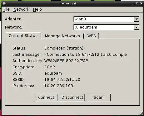

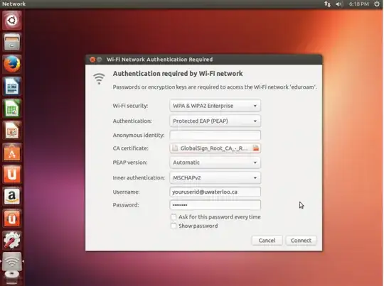

I'm currently trying to connect to my University wifi network and it's of WPA2-Enterprise type.
I found the setup instructions online and I followed them when setting it up using wpa_supplicant.

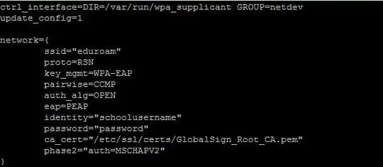

The picture above is the settings the school suggests and below is the code I have in my wpa_supplicant.conf file.
However, I am not able to get internet access even though I am connected.

This guy has the answer:
If you have the cert then this should work for you.
This is how I did it.
First I grabbed the public certificate that the RADIUS server was offering and saved it as a PEM file.
sudo mkdir /etc/certs
sudo cp radius.pem  /etc/certs/
Then I edited /etc/wpa_supplicant/wpa_supplicant.conf
ctrl_interface=/var/run/wpa_supplicant
network={
  ssid="MySSID"
  scan_ssid=1
  key_mgmt=WPA-EAP
  pairwise=CCMP TKIP
  group=CCMP TKIP
  eap=PEAP
  identity="raspi"
  password="mypassword"
  ca_cert="/etc/certs/radius.pem"
  phase1="peapver=0"
  phase2="MSCHAPV2"
then edited /etc/network/interfaces auto lo
iface lo inet loopback
iface eth0 inet dhcp
allow-hotplug wlan0
iface wlan0 inet dhcp
    pre-up wpa_supplicant -B -Dwext -i wlan0 -c/etc/wpa_supplicant/wpa_supplicant.conf
    post-down killall -q wpa_supplicant
It sounds simple but it took me a while to crack it. I am also the person who set up the RADIUS server (FreeRADIUS) so I have some inside knowledge. I hope this helps.
