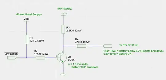

I would suggest the following circuit:
A simple Common Emitter stage with a 10KOhm pull up resistor (R1) onto the LBO pin and a series 47KOhm resistor (R2) to the base of a generic NPN transistor (Q1) stage with a collector resistor of 2.2KOhm (R3) to the RPi +3.3Volt supply and another 47K series resistor (R4) to an RPi GPIO (input) pin.
R1 provides enough pull-up current to turn on Q1 under "normal" conditions, R2 prevents the forward biased Base-Emitter junction from clamping the LBO pin to only 0.7V above ground when the transistor is turned on - otherwise the LBO LED on the Power Boost board would be constantly on, even when the battery was above 3.2 volts! R3 permits enough current to flow through Q1 to allow the transistor to saturate so that a typical VCEsat of 0.5 Volts can be achieve which will be the input level via R4 that the RPi will see (no internal Pull-up or Pull-down should be set on that GPIO pin). When the Power boost battery level drops below the 3.2V level the drive to Q1's base is still enough to operate but when the LB Output is pulled to ground level by the IC on the Power boost module there will be no more drive current, Q1 will switch off and its collector voltage will raise to the 3.3V RPi level, by the action of R3 so when the RPi detects a High level on the selected pin then it is time to have a GPIO monitoring script run in the background from rc.local (or whatever new-fangled method systemd forces its users to use) to execute shutdown -h -p now Battery exhausted on PowerBoost unit!
