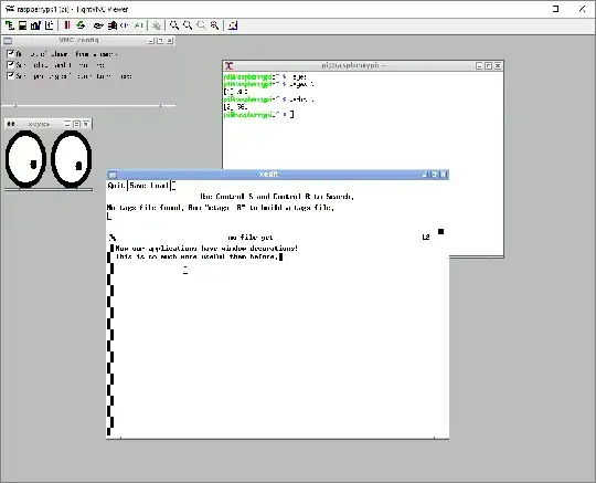

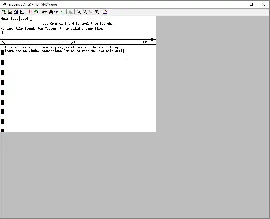

Without a window manager: Without a Window Manager
With a window manager: With a Window Manager

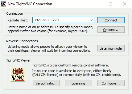

  4. Connect using a vnc viewer and enjoy!
TightVNC Viewer is one option:
(I picked it because it is FOSS and has an MSI installer).
Remember to do :1!
You'll have to enter the password from earlier:
You will be prompted for the password you set.
