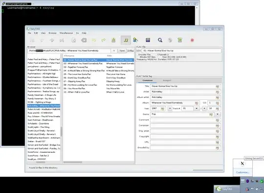

Now, if you try to start a graphical program (say, easytag), it will open a new window on your laptop.
graphical easytag program running on a raspberry pi, but the program window is displayed on the laptop screen
