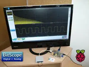

We have found the Raspberry Pi to be an excellent platform for running the software you'd need for a project like this. The problem is getting the signals into the RPi in the first place and performing high speed jitter free real-time signal capture on the same CPU that's running the O/S and application software. Our solution is the BitScope Raspberry Pi Oscilloscope which pairs a BitScope (for high speed mixed signal waveform capture) with the Raspberry Pi which runs all the necessary software.
BitScope

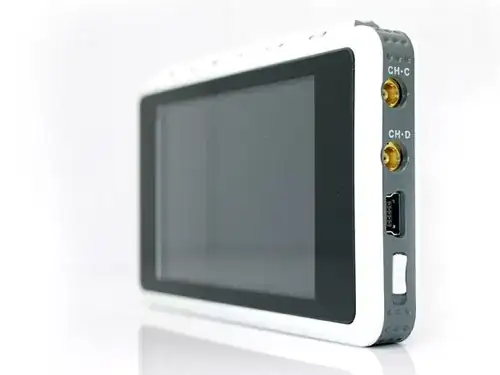

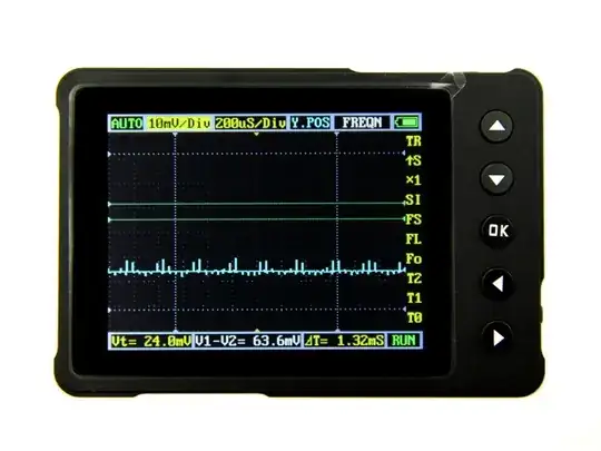

There No need to re invent the wheel here. For example a DSO Nano for under 100USD single channel.
A DSO Nano Quad Channel for under 200USD

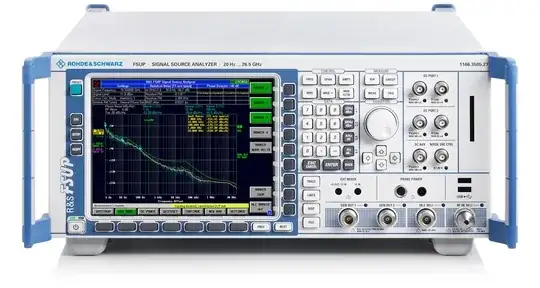

And then, what a Raspberry or similar device CANNOT DO!
And cost a small fortune ...
  • Upto 110Ghz, with hard drive to store data, extremely precise, simulations and triggers.
  • Measures Buuetooth, WCDMA/EDGE/3G/4G, Wireless A/B/G/N 2.4Ghz/5Ghz, SATA, AGP/PCI/PCI-Express, Raw Satellite signals, Hard drive head channels, Ethernet, etc, etc ...
