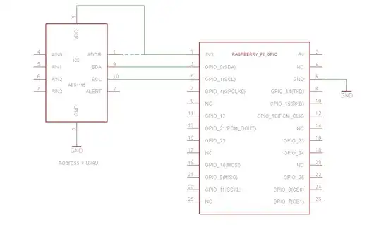

ADS1115
The ADS1113, ADS1114, and ADS1115 are precision analog-to-digital converters (ADCs) with 16 bits of resolution offered in an ultra-small, leadless QFN-10 package or an MSOP-10 package. The ADS1113/4/5 are designed with precision, power, and ease of implementation in mind. The ADS1113/4/5 feature an onboard reference and oscillator. Data are transferred via an I²C-compatible serial interface; four I²C slave addresses can be selected. The ADS1113/4/5 operate from a single power supply ranging from 2.0V to 5.5V.
First you need to make sure the I²C modules are loaded. Next connect the ADS1115 as shown below. There are 4 different addresses possible depending which pin ADDR is connected to. This means you can connect a total of 16 channels to a single I²C bus.
GND=0x48, VDD=0x49, SDA=0x4A, SCL=0X4B
You can see the result of the last conversion like this
# i2cget -y 0 0x49 0 w
0x0000
The default of 0x0000 is returned here since no conversions have been performed yet. Now lets take a look at the config register
# i2cget -y 0 0x49 1 w
0x8385
The LSB is first, so this is equivalent to 0b1000010110000011
I'd like to do a single-ended conversion on AIN0, so I need to write bits[14:12] as 0b100. ie 0b1100010110000011
# i2cset -y 0 0x49 1 0xC385 w
0xa30b
The LSB is first, so this is equal to 2979 decimal
