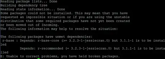

First Try I tried to follow the official description on the CRAN-site (the link doesn't work properly, you need to click through: Download R for Linux -> Debian and then scroll down to "Supported Branches" and "Jessie", where it gives advice to Jessie users. What I did was sudo nano /etc/apt/sources.list and added the line deb http://cran.rstudio.com/bin/linux/debian jessie-cran3/, and then tried to install it again (after removing it with sudo apt-get remove r-base) sudo-apt-get install r-base. But I got the following error:
Error Message
What am I missing/doing wrong? Thank you very much for any ideas/help/advice.
Beware that binary packages from there, such as the R interpreter itself, will only work on specific architectures, presumably at least x86 and x86_64.
But you would need one compiled for ARMv6. If you are using a Pi 2 you could also use ARMv7, which is more commonplace, but likely still not available in the repository.
This is why adding that repo will not allow you to upgrade the R version -- you would not and cannot have the proper dependencies available for an x86(-64) binary package, so it cannot offer you the higher version.
There may be pure R packages from there that you can use but obviously if they depend on a higher version of the interpreter then you will need to find that somewhere first.
