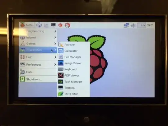

Now you can access the keyboard:
Menu >> Accessories >> Keyboard
Access the keyboard
If the keyboard isn't visible on the menu you can enable it by going to:
Menu >> Preferences >> Main Menu Editor
There you will be able to enable the keyboard.

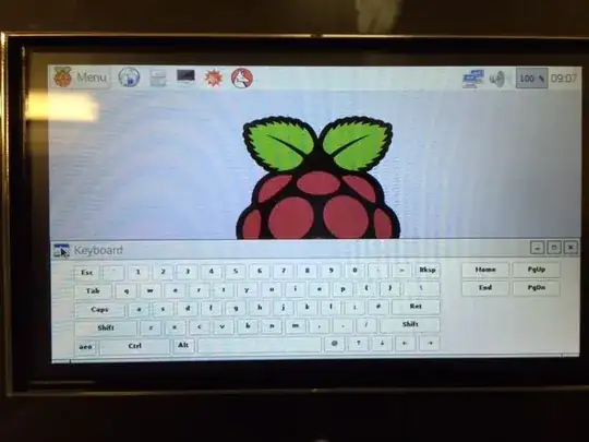

If everything has gone perfectly you will now have an onscreen keyboard.
Onscreen keyboard
