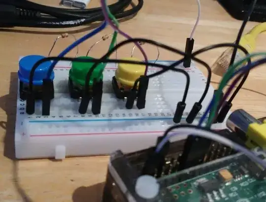

Here's a pic of the connections. There are lots of explanations of button circuits around. These use external pull-ups. In case it isn't obvious the button contacts connect numbered rows when depressed, not the top half of the board to the bottom.
Here's the code. To see this in action, place both files in the same directory, set test.pl executable (chmod 755 test.pl), and run ./test.pl (also note the different extentions, .pl and .pm). You'll have to use ctrl-c to exit and there's no clean-up, so the directories will still exist in /sys/class/gpio. You can restart it without closing those, however.
