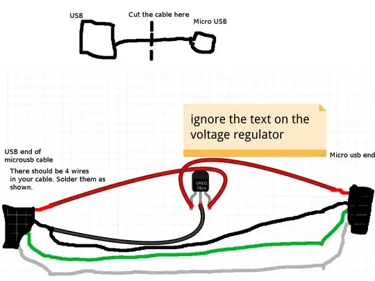

You could buy https://www.adafruit.com/products/2236. It is a 5v regulator. Then, you can cut apart a micro usb cable and put this inside. Look at the datasheet https://www.adafruit.com/images/product-files/2236/2236.pdf. It will tell you the pinouts.
You might be able to find this in other places.
Edit: Wire diagram
This should help. Which end you solder the wires to matters.

Instead of risking your lives (the IC mentioned in the accepted answer only handles ~250mA), try a pre-built voltage regulator.
