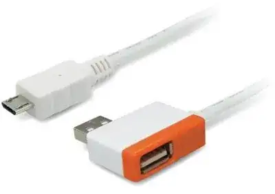

I'm planning to buy the latest Raspberry Pi (Zero) and I'm trying to figure something out. Let's assume I have a decent power supply (2A) and I'm using this cable for powering it and powering an USB HUB.
A strange 3 in 1 cable
Connections:
  1. Male Micro USB: connected to Raspberry Pi
  2. Male USB: connected to a charger (2A)
  3. Female USB: connected to a HUB
Will this setup provide:
  1. power to Raspberry Pi AND
  2. extra power to a HUB AND
  3. connection between Raspberry Pi and a HUB
I'm planning to attach a Wi-Fi plug and an external USB drive to the HUB so the HUB should also be powered by a charger (just in case). I heard mixed opinions about this setup. I have to be sure it will work like a charm.

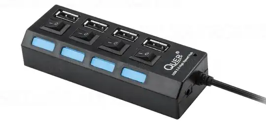

Why not 2 output charger, the first one to the Pi, the second one to the HUB? Well, I'm thinking of this HUB (I love it) and it requires an extra charger (not USB standard).
An awesome HUB I want to buy

It is possible it may work.
If you plug the big USB into the HUB and your power supply USB into the big USB which is plugged intot he HUB, then the small USB into the Pi power, that should provide power to everything.
Then you plug the USB HUB, USB host cable into the Pi and that should recognise the HUB in Raspian.
Theoretically you will have 3 usable USB ports to use then.
It is a bit strange way of doing it, but you have the cable that can do it. So it should be OK as the USB connection on the Zero does not seem to be connected to 5v, so you cant power the Pi via the USB, only via Power. If it was, you could back power form the HUB. As long as you don't use any other power supplies in the circuit it will be fine.
