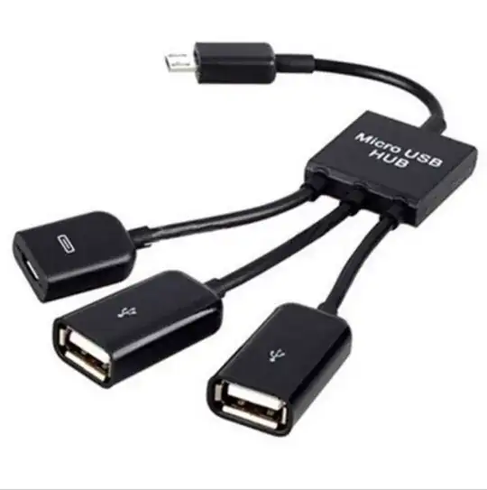

There are OTG [On the Go] hubs, which are micro usb. They work a bit differently than a standard usb hub, which uses a barrel jack for power. This one from eBay is extremely cheap, and it doesn't look like it has a slot for power, but the port on the far left (in the below picture) is the power port. It takes the standard micro usb 5V 1A cable, just like the Pi, so it shouldn't be hard to find a power cable for this hub, or any other OTG Hubs.

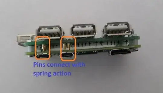

The Hubpixed is not a power hub, but it draws power directly from the main board and therefore you should be good. It does not require any cable or soldering and connects seamlessly to the Pi Zero.
Hubpixed - Raspberry - Pi Zero USB Hub
