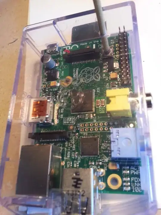

I've used that shutdown.py solution too.
You'll still need to find a physical switch and solder it to pins 6 and 8 of header 5. I took mine from an old broken Arduino board. I've also drilled a small hole in the case to make sure that I can push the button with a small wooden pin when the case is closed.
This is how it looks like:
Screenshot of the switch arrangement
