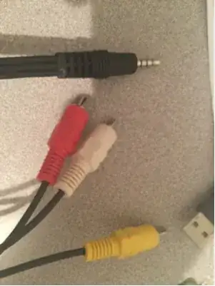

So I have a Raspberry Pi 2 Model B and I want to connect it to a computer monitor that only takes composite video input.
This is what I'm using to output composite video:
I've edited the config.txt file to ignore HDMI output and use NTSC video. I've also commented force_hdmi so that it wouldn't force that output.

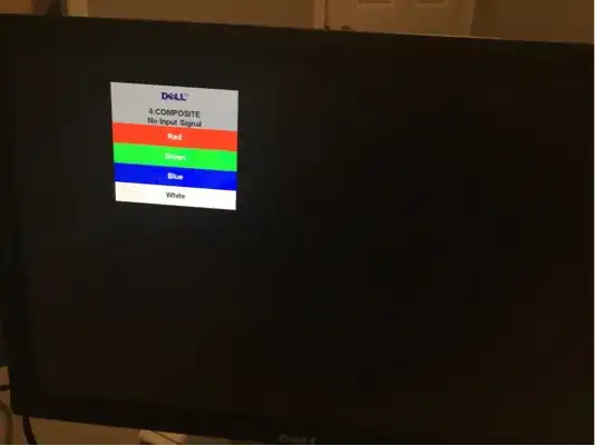

But this is all I get:
No input signal.
What should I do?

Try switching the red and the yellow.

I think if you have to press key 2, 3 or 4 to change to compose video, also add this line on config.txt :
sdtv_mode=2
Also
hdmi_ignore_hotplug=1
However it may be the wrong cable as explained on raspberry.org
Raspberrypi.org
Jacob Sánchez
  • 243
The red plug contained my video (on my cable) also. Your mileage may vary. Do like I did & switch them around until it either works or doesn't.
