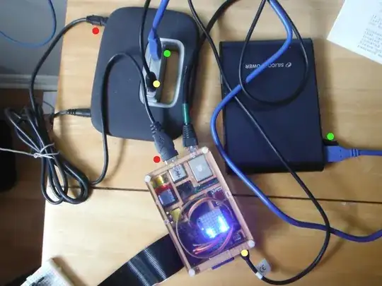

to be more specific, I have a powered usb hub plugged into the pi (and the wall) and a Western Digital 1TB external hard drive plugged into the pi (I can hear it running)
