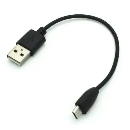

I connected,below wire enter image description here

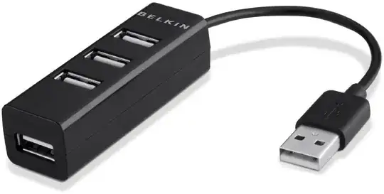

to a USB hub, enter image description here
and connected the pin to Raspberry Pi zero but it did not work.

Note that the very same hub you have bought exists in OTG variant as well:
This one should work with RPi Zero just fine. Check out the shop you got your hub from: perhaps they have the OTG model as well and are willing to exchange the hub you have bought for the one you actually need. Or just keep the hub you got for your laptop, and buy a new one for the RPi.

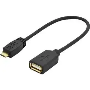

Another solution is to buy an OTG cable which will enable you to use the hub you have:
