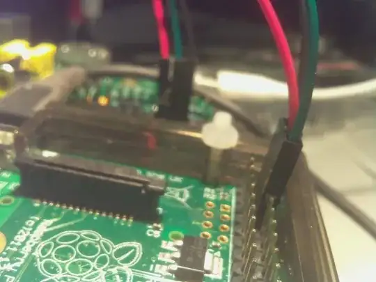

Did you consider connecting the devices directly with simple dupont wires between their UARTs (GPIO Pins 14 and 15) ?
The UART pins are also known as Pins 8 and 10
If you are very adventurous , you can install pppd and even use IP-based tools over the serial link (SSH , FTP etc.) -> See here
