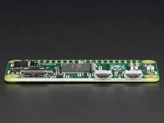

You’d need Raspberry PI Zero for OTG or so called Gadget Mode. Data USB port can be used for OTG and “power”. As of time of this writing Serial and Ethernet were tested, but others should work with proper amount of efforts (keyboard, disk, camera, etc.) Composite devices should work as well. See more info at

On the zero, zero W and the 4B device mode is possible out of the box.

Can the Pi Emulate an HID device with via USB?
This can be done with ANY kind of Pi
The least-expensive solution is to use the Pi Zero.
The text of this link is way too long to post here, but the Zero can be any kind of HID. Keyboard, mouse, flash drive, camera, whatever you can think of.
Turning your Raspberry PI Zero into a USB Gadget
Making it a keyboard or mouse is easy.
