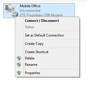

I tried to investigate the sequence of AT commands that windows sends by using a serial port sniffer. I connected my USB modem to my PC and started the dial up modem interface by right clicking on it and selecting connect.
The modem connects and all the AT commands are logged. Modem COM port log:

After that I tried to start the modem manually by running the AT commands from the log. I get an OK response for all commands until I hit ATDT*99# which gives CONNECT 100000000 and hangs. I don't understand, I used the same AT commands in the same order. It doesn't start when I run it manually, but it starts when I right click on the adapter select connect, which in turn runs the same AT commands. What is the extra thing that windows is doing on clicking connect?
