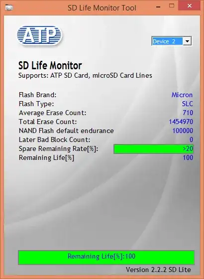

For ATP branded Industrial SD Cards, they provide "SD Lifetime Monitoring Tool" software for Linux/Windows. But if you use this tool you must run this tool from a Host Operating System. That means you can not use this software inside SD Card to check itself. Because if you run this software, SD card can not be accessable.
For Reference - Google: ATP Industrial Grade SD Card Specification (Revision 3.8)

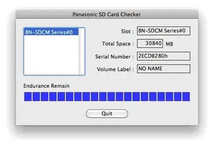

I just came across a tool to check Panasonic SD Cards for remaining endurance:
https://av.jpn.support.panasonic.com/support/global/cs/sd/tool/card_checker.html
It only has Mac and Windows versions though.
