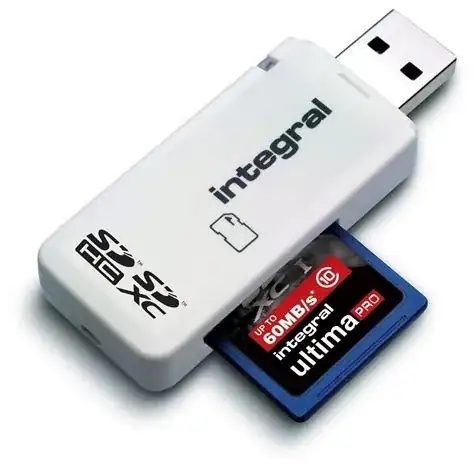

I'd like to take this opportunity to reinforce the utility of having spare SD card(s). Instead of having to write your dd-copied-image to a thumb drive, you could use something like this, and simply pop it in your RPi's USB drive - so much easier!
SD-USB-Adapter
Once mounted, you'll be able to assess what you've got to work with. If it looks good, you can cp or rsync your files from the old to the new SD card.
