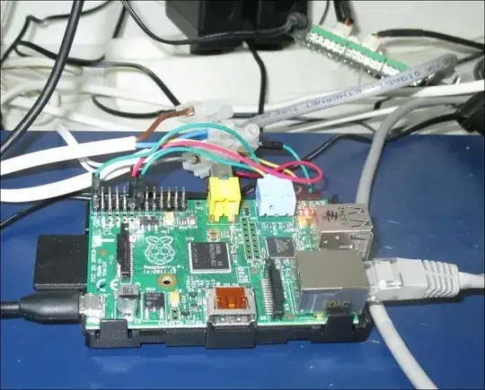

My physical setup is like this (maybe hard to see):
My Raspberry Pi model B setup
There are a few terminal strips, 1-wires and the length of the pulse cables are aprox 1-2 meters (not twisted pair).

Though I have dramatically reduced the weird ghost pulses by replacing the pulse wires with network twisted pair cables, I am not sure I have 100% eliminated them as I suspect there to be minor issues when receiving multiple pulses simultaneous on several GPIO pins. I am considering to try out the hardware debouncing option, which I have not done yet - just to rule out if this can help or not.

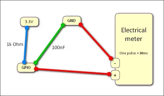

Can someone please advice if this drawing below will be perfect for my setup? Is the resistor and capacitor good with a 30ms pulse from the electrical meter or should I instead use a bigger/10uF capacitor (10ms?)? Then of course I should scrap the internal pull-up resistor and the software debouncing.
The full Kamstrup 382L data sheet is here but this is what they write about its "S0 supply":
Sends 24 V via 2-wire and pulses by drawing the voltage to 0 V at every pulse.
This is what I plan to test:
Hardware debouncing
Sorry for reasking this again but I really want to make this as good as possible and not fry my RasPi (I have no clue about hardware);-)

No harm in using a capacitor. Connect one between each gpio you are reading and a ground pin. As close as possible to the gpio's pin.
Similarly no harm in using your own 10K resistor instead of the built-in (50K) resistor. The lower value will give better protection against interference on long wiring.
That said, a bounce-time of 350 ms should be more than sufficient to squash any spikes, so there is something odd going on.

  1. Connect to the Pi GND as common NOT the +3.3v rail.
  2. Take measures to reduce interference. E.g. use twisted pair (or shielded cable) - a separate cable for each meter, with the only common connection the GND at the Pi end.
  3. Use low impedance circuitry e.g. a low value pullup e.g. 1kΩ unless there is power limitation.
  4. Adopt bounce suppression. Remember this needs to be BOTH on contact closure AND contact open. This can be done in software and/or with capacitor to slow transitions.
There are other isolation measures, but the above should suffice for most purposes.
EDIT 2. The picture you pasted seems to show a separate cable for each. Using power cable seems overkill, and simple twisted pair would be better. 3. You are using internal pullups i.e. 50-150kΩ. Use 1kΩ to reduce impedance. 4. I don't know the detail of Python bounce suppression, but the device only puts out 35mS pulses. I would use a capacitor from each input to GND. This ensures the contact closure will deliver a sharp pulse but bounce (or contact open) will be slowed down. You can calculate the time constant from R*C. 1kΩ * 100nF gives 100μS. I would use larger capacitors.
The rats nest of wiring is hardly going to be resistant to interference. A Pi with just unterminated wires will trigger interrupts in a normal environment. You need to use better layout.
