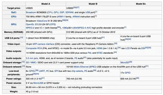

You have not done research.
The minimum requirements for Windows XP are (from Microsoft Knowledge Base):
  • Pentium 233-megahertz (MHz) processor or faster (300 MHz is recommended)
  • At least 64 megabytes (MB) of RAM (128 MB is recommended)
  • At least 1.5 gigabytes (GB) of available space on the hard disk
  • Video adapter and monitor with Super VGA (800 x 600)or higher resolution
  • Sound card
Raspberry Pi does not meet those requirements, due to the fact that the maximum Raspberry Pi specifications are (from Wikipedia):
So, to answer your question: no, you can't.
And please do more research in the future. Do a Google search for Can I run Windows XP on Raspberry Pi, you'll find many topics and answers to them, with the answer: no.
