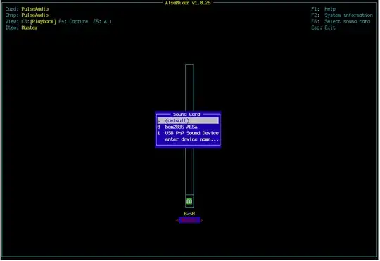

If I run alsamixer and set the audio to USB PnP Sound Device, I can hear audio through the USB sound card. To make it permanent I type:

Turns out that the OP was thinking along the correct path with his trying
$ sudo nano /etc/modprobe.d/alsa-base.conf
and changing the index from -2 to 0 via adding options snd-usb-audio index=0 to the file. However, this wasn't working.
The correct way to do it is to add options snd-usb-audio index=0 followed by options snd_bcm2835 index=1.
Essentially what doing this is forcing the default sound module (snd_bcm2835) to be disabled while the usb sound module (snd-usb-audio) is enabled.
What I believe was previously happening with just adding options snd-usb-audio index=0 was that the snd-usb-audio module and the snd_bcm2835 were conflicting, with both being enabled.

With Raspbian Jessie and newer (Stretch, Buster, Bullseye), changing the default audio device is simpler than it used to be.
Now, simply use this command to list your alsa-detected sound cards, and take note of the card number of your preferred device.
aplay -l
Then create/edit the alsa configuration file at ~/.asoundrc, or the system wide one at /etc/asound.conf, and paste these lines:
pcm.!default {
    type hw
    card 0
ctl.!default { type hw
card 0 }
changing card 0 to the card number of your sound device.
Use alsamixer to double check that the default has been set correctly.
