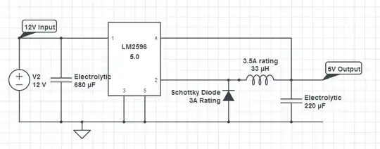

You would need a buck converter like LM2596. It can drive upto 3A at high efficiency. In contrast, 7805 heats up pretty quickly. If you want to connect many modules to the pi, please go for buck converter option. You can find more info here
LM2596 based voltage regulator
Needless to say, high efficiency => More power left for your radio application

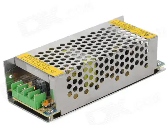

I would suggest getting a better power supply. If you try and run an Amp and the Pi off that crappy, cheap power supply you are going to have issues, especially with WiFi on the Pi because of the incredible noise generated on them. Also, you might run out of power when your crank up the volume causing the Pi to reset (brown out)
I usually suggest switching power supplies, like the ones used in computer. They provide high quality, clean power and are very efficient.
You can find them on dx.com and ebay12 volt ($10-$15) for 5Amp, but then you still need 5volt right? Many people suggest an ubec dc-dc

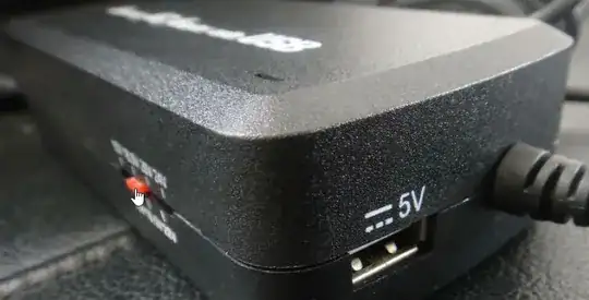

You can also try and find a universal power supply with a USB port. So the lead will supply 12volt and you can power a HUB with various things and the Pi.

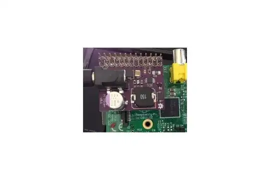

I recently became aware of PiPower, which looks like it could do the job too:
Pi Power is a switching power supply for the Raspberry Pi. It plugs into the GPIO header, and has an extra tall stacking header to keep the board out of the way of the display connector and facilitate plugging something else into the GPIO connector as well.
It has a 2.1mm barrel connector that will accept 6-15 VDC. It supplies up to 2 amps of 5 volts. At supply voltages over 9 volts, it has a ripple of 25 mV P-P. At lower supply voltages, the ripple goes up to 45 mV.
