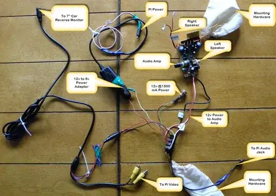

You will have to purchase an amplifier. I took an old set of computer speakers and grabbed the amplifier out of it. It runs on 12v. This is a snippet from my tutorial on a Pi Arcade:
Power Harness and Audio Amplifier
When you are ready to cram all the components of your Raspberry Pi arcade into a MAME cabinet, you have the choice of suppling power to pcb, pi and monitor separately or create a single power supply.
I decided to create a single power supply with the following components. I purchased a Wall Wart Power Supply - 12VDC 1.5AMP at a local electronics store to be my main power source. I needed 12v to power the monitor (a 7" reversible car monitor). Since the pi only needs 5v, I used an old Tom Tom GPS car charger to drop the 12v to 5v. In addition, I added a audio Amplifier (12v also), The pi's audio is very low, so adding an Amplifier is needed. I found an old computer's external speakers amplifier and used it.
Pi Arcade tutorial with Audio Amplifier
Amplifier
