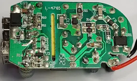

An improperly isolated power adapter driving Raspberry Pi can cause electrical shock.
Usually most power adapter usually used to drive Pi are SMPS. Below is a picture of proper SMPS isolation:
You can see a large slot on the PCB (below text L-4765) that provides electrical and physical isolation between the primary and secondary sides of the power supply. No tracks or electrical connections are routed across the slot.
New cheap manufacturers can cut corners and don't adhere to standards and hence may not isolate the primary and secondary sides properly. The primary side is connected to Live AC voltages.
Here is an article that has more details.
Wikipedia article on SMPS - Search for "shock"
Power supply isolation article by Sunpower
