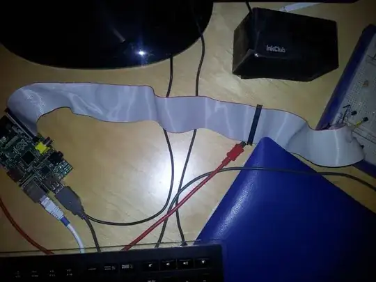

Rpi with flat cabel to bread board

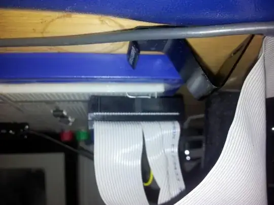

Just wanted to share how I did. Found an old A: (disk drive) flat cabel, connected it to the pi in one end and the other to the bread board. At the bread board end I put some metal thread between the output of the flat cabel and the input holes in the board (inexpensive).
Metal thread in board
Here one can see the metal going from the cabel to the boad.
