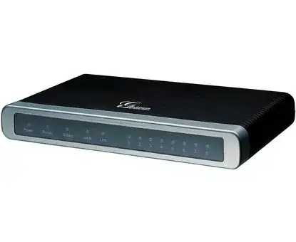

Assuming you can get Asterisk rolling, I'd probably go for one of the ethernet connected FXO boxes. Many companies make them. Here's an example:
Official Grandstream web site with details

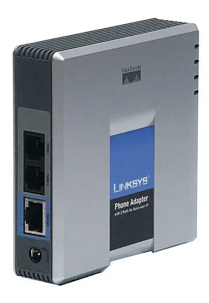

After you have set it up the way you love you can consider one of these amazing devices from linksys/cisco. (That wont cost you hundreds and hundreds!)
Linksys PAP2
A really really cheap solution to enable your existing home phones to use VoiP instead- If you want to recieve phone calls on your existing number, you can buy a cheap DID for voip and then redirect all incoming land line calls to your VoIP DID. Sorted

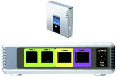

Linksys SPA2102
This is a step higher and can act as a repalcement router but does not have to. It jsut has the facility. This model allows you to use 2 VoiP lines/channels and connect 2 phones or 1 phone and 1 fax or 2FAX's. What ever you fancy. Again you can redirect your land line to your Voip DID
  • About £40-£60 (these are not made by Cisco/Linksys anymore - So check eBay)
Linksys SPA3102
I currently use this one at home because it allows me to connect my existing land line and set up dial routes inside the SPA3102 to select if it should use landline, like toll free numbers(because allot of VoIP and mobile providers charge a small amount) or VoIP
  • About £60-£80 (these are not made by Cisco/Linksys anymore - so check eBay)
